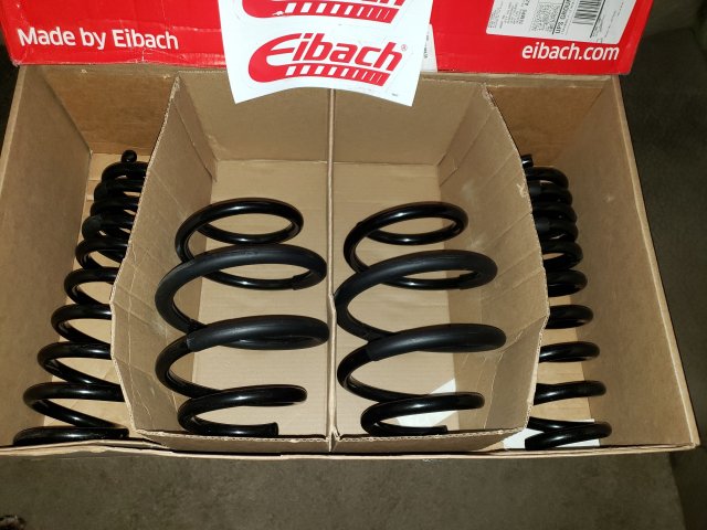

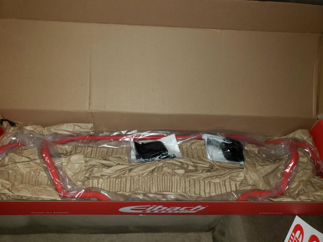

Hurry up and get me some pics!!! ;)

I have an appointment on Monday to have it installed, pictures will come after.
