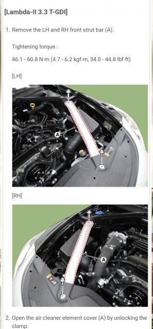

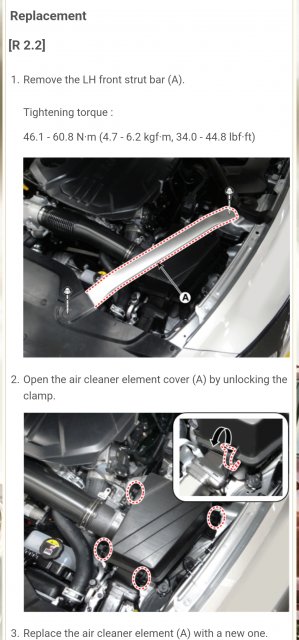

I searched high & low across the internet (including this great forum), for torque specifications for reinstalling the radiator braces (what many mistakenly refer to as suspension tower braces), and found nothing. So, I thought I'd post my experience here.
Using "reverse engineering" (removing the braces by dialing-up my torque wrench 1 foot-pound at a time until the nuts started to loosen), then averaging the torque among all four bolts, it appears that the OE torque is in the 24-26 foot-pound range.

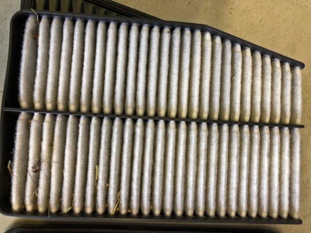

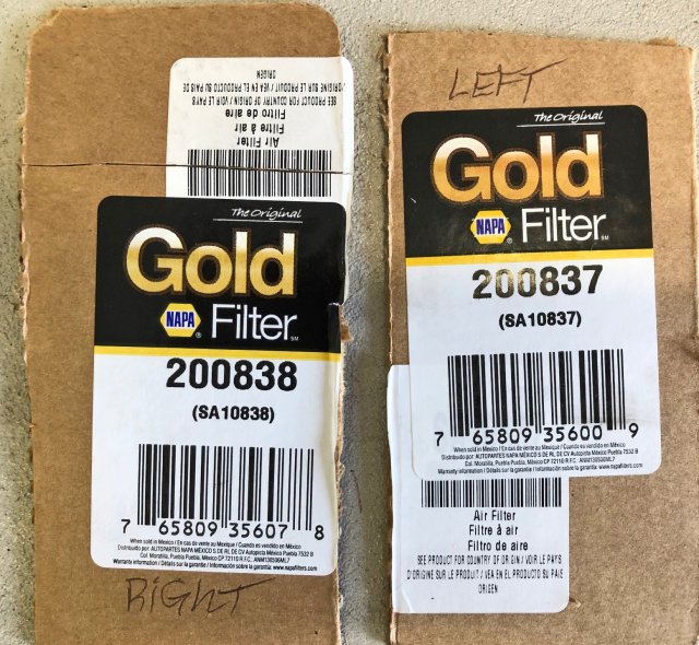

a) WIX makes the best air filters (SA 10837 and 10838), and markets them for NAPA as "Gold" (200837 and 200838), for just under $20 each. These new replacement filters appear to be a slightly better / thicker fabric than OE.
b) When I installed these at ~12,000 miles, the original OE filters were VERY dirty (by comparison, the new filters are pure white). In the future, I will replace at ~10,000 miles, as higher-boost turbocharged engines suck a tremendous amount of air, requiring more frequent filter changes than in naturally-aspirated engines.
c) When replacing filters, I treat the filter area like a 'clean room', vacuuming all external and internal housing areas, then wipe the inlet filter housing-to-turbo hose with a damp white cotton glove before re-assembly.
