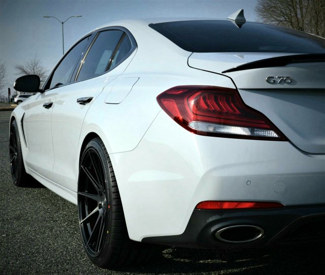

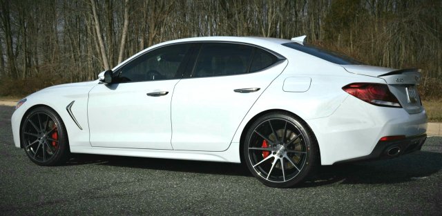

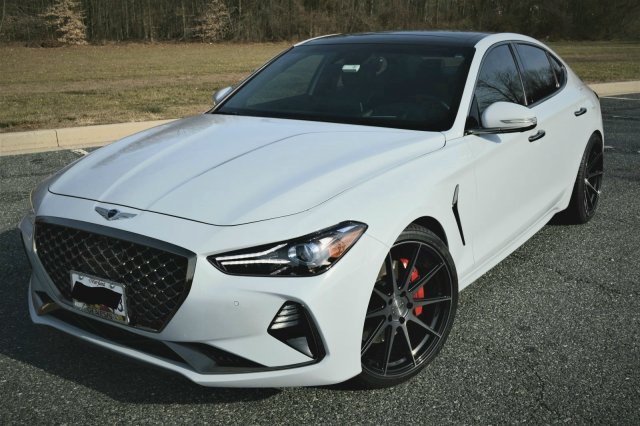

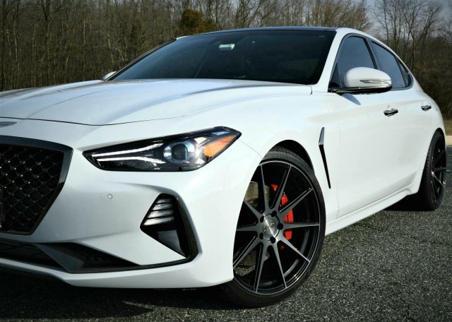

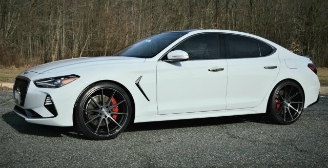

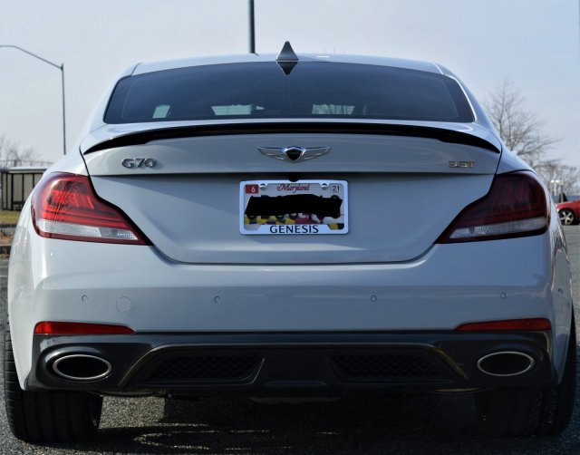

I havent seen too many modded G70s on the internet let alone in person, so sharing mine in case anyone is looking for inspiration.
My goal was to balance a bit more sportiness and aggression while still looking luxurious. I also wanted it to look as if the factory produced a higher performance model fitting of an S or N badge.
Because there arent too many examples out there, I used a lot of data from Kia Stingers, took measurements, and some risk. ;-)
Tech details:
-2019 3.3T Sport RWD
-20x9 +32, 20x10 +40 Vertini RFS 1.3 rotary forged wheels
-245/35/20, 275/30/20 Falken FK510 tires
-Eibach Prokit for Stinger GT (.8" drop for RWD cars); works with factory dynamic suspension.
-Moya rear trunk spoiler
Ride is firmer, but handles better. Wheels are lighter than stock 19" sport wheels. Not my daily driver, so only a hundred miles on this setup but so far, no rubbing.
Wheels were custom machined for the car and took about 3 weeks. Came with preprogrammed TPMS. Had one sensor that had to be reprogrammed, but the vendor sent me a programming tool to use and send back. Works flawlessly now.
