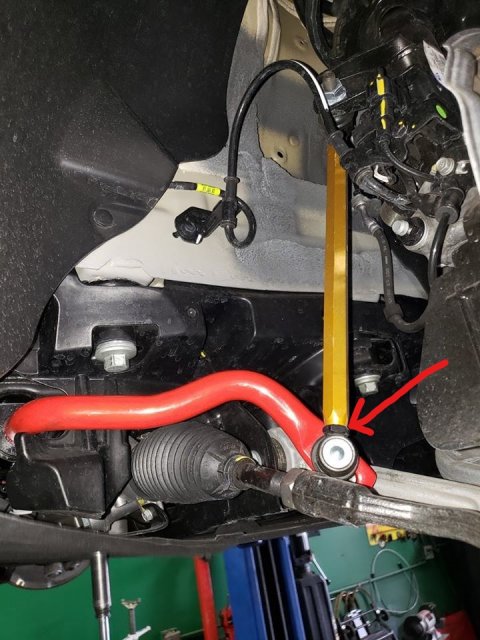

Moving to the front of the car. A 10mm socket is used to remove the brake line bracket on the engine side of the strut. A 10mm socket is going to be used to remove the bracket behind the caliper towards the front of the car.
Then switch to a 13mm socket to remove the bolt for the bracket above. This allows you to move the wiring out of the way in order to unclip the sensor behind the strut.
Use a 17mm socket to remove lower strut bolts. We sprayed WD-40 around the strut bolts so that they would slide out easier. The lubricant is optional.
The nut towards the top of the strut is a tricky one. Grab your 17mm crescent wrench to hold the nut in place while you use a socket wrench with an Allen key to loosen the inner bolt. The link should slide out.
Unbolt the outer tier rod. First remove the holding pin. A 19mm is the used to remove bolt on steering knuckle. Grab the rotor at 3 and 9 o'clock and mimic left and right turns to loosen the outer tie rod bolt and then pull out.
